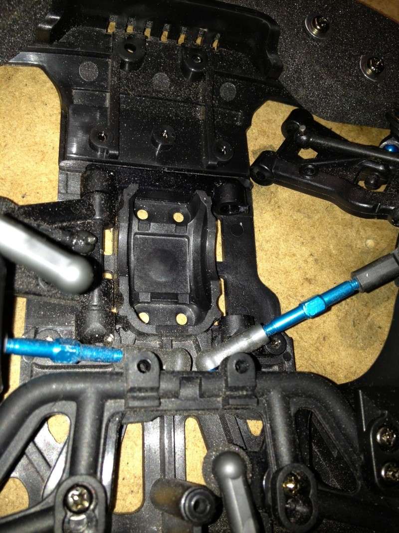

Hi All,
Just want to share pics of my XV-01 Pro kit build before the New Year !!! Happy New Year everyone, keep RC-ing and enjoy:
Elec compartment is a real tight fit.
37mm wide x 44mm long x 36mm high (with shroud on)
Battery pack not thicker than 25mm
Front differential Gear Box with Slipper Clutch hop up.
Finally Done. What's left is a paint job. Happy 2013 everyone......

Another top down look at the XV-01 chassis. As ESC is all the way at the back, this needs a longer then usual sensor cable (300mm) and longer lead cables from the motor to reach it.
Initial opinion is that the stock suspension seemed quite soft and would easily bottom out. Think may need to change to heavier damper oil and stiffer springs very soon. Although there are mounting provisions and brackets front and back, the kit does not come with an ARB
Bottom View
