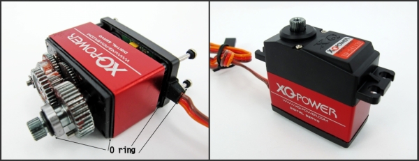

Xq-power stated splash proof . There are O rings all round, even the screws. Maybe they haven't test dipping the servo in water.
The BMS-620 looks exactly like Axial AS-2 servo but this one is waterproof.
The casing have rubber fittings. But the AS-2 have none.
Dun have the explode view, not sure whether the output shaft have internal O rings.
Plastic gears inside. AS-2 metal gears, maybe can swop.
Review no good , maybe not for bashing use.
Re: Waterproof servo
Post by boolean21 on Tue 1 Nov 2011 - 23:44
i only opened the first bms620mg the i bought... the rest of the 620mg and 620, i only greased the output shafts...
hmm... that time when i opened, i remember there was a thin rubber gasket in between the rear casing cover, other than that, i didn't really check for other O rings at the other locations...
when i closed it back, i was worried that i didn't put the rubber gasket properly, so i just silicone in between the gaps where the casing closes... kiasu ma... Very Happy
that is the first bms620mg that i bought for my honcho... till now, the servo is still working great... swam, mudded, etc.... bms620mg gets my vote! Very Happy
