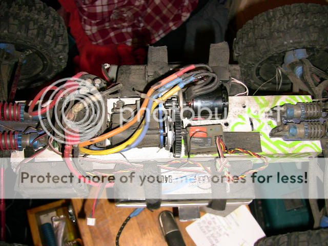

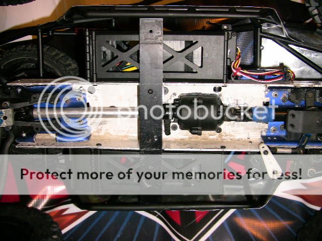

This flush mounted 7075 cross brace supports the batteries and also keeps the body from flexing or trying to shift.

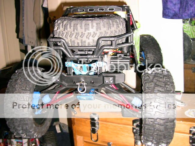

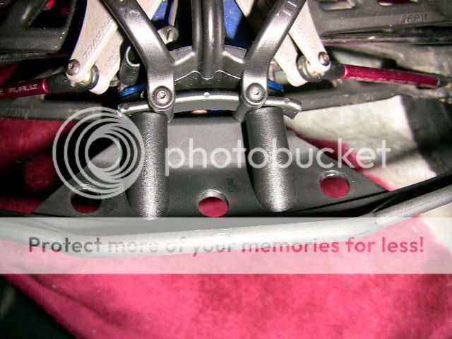

The rear bumper acts as a bump stop.
YETI XXL HYBRID - Page 2 YETI%20XXL%20002_zpsbfv00yn8YETI XXL HYBRID - Page 2 YETI%20XXL%20003_zpstwydn8wz

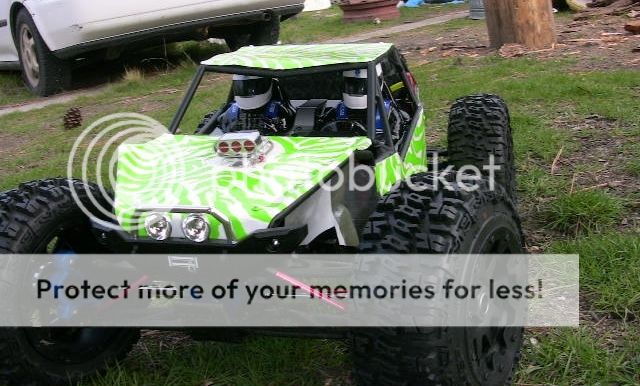

Post by twissted Thu 26 Feb 2015 - 11:35

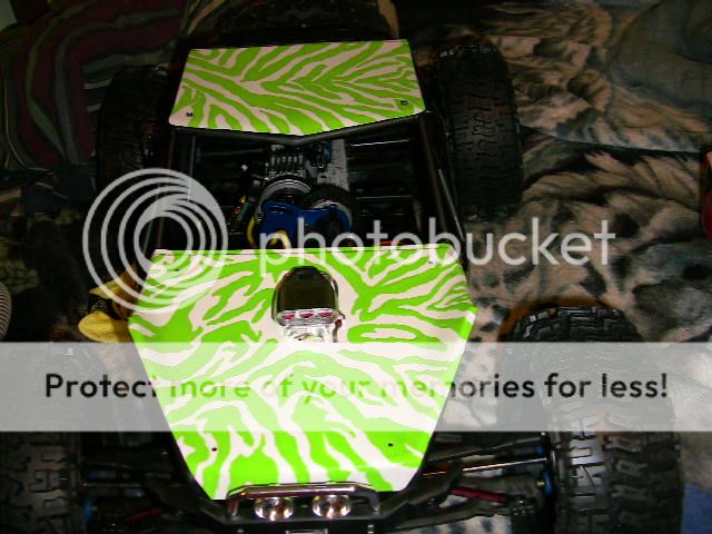

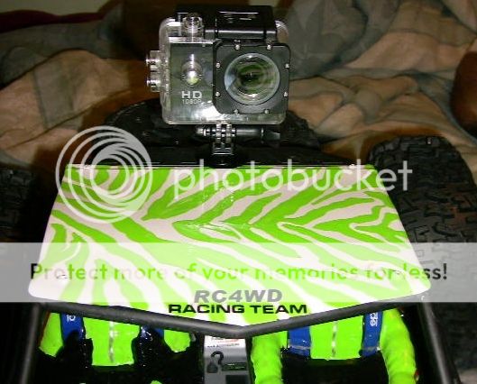

I'm going with a Green and White Zebra theme.

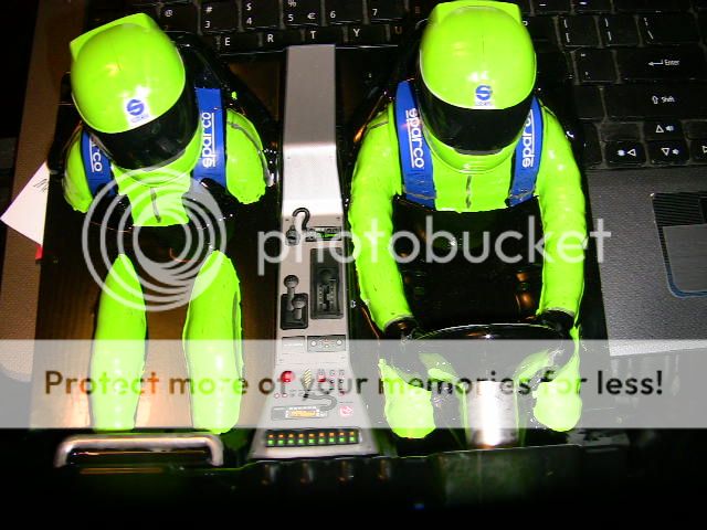

The interior showed up. I plan to add some paint to it so that it matches the outside panels.

Wow, looks fantastic! Nice vibrant color. And of course the interior brings it to life!
YETI XXL HYBRID - Page 2 Empty Re: YETI XXL HYBRID
Post by twissted Fri 27 Feb 2015 - 13:44
I got tired of painting. I have another coat to go and some more detail to go.
YETI XXL HYBRID - Page 2 015_zps8d1blpirYETI XXL HYBRID - Page 2 018_zpsh4jz7p33YETI XXL HYBRID - Page 2 017_zpsrljxydlbYETI XXL HYBRID - Page 2 016_zps0m1xqjwi
Amen to that! It really pops now!

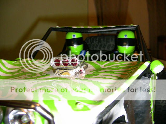

Post by twissted Sat 28 Feb 2015 - 11:31
Hood pins are in and the motor is detailed.

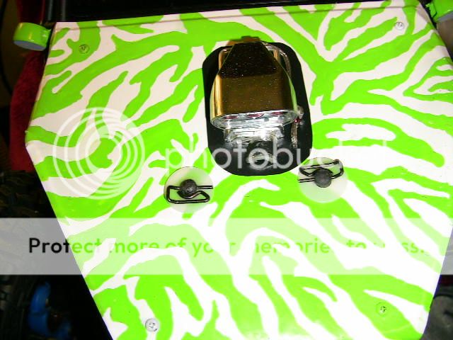

I made a strap for the hood pins as well as a tow strap the gear cover came in today also.
YETI XXL HYBRID - Page 2 009_zpsyydjjjtaYETI XXL HYBRID - Page 2 33dc952c-3baf-466d-9e0b-2b37b3687fea_zpsh8daad9s

The reason for the bumper is not just for looks but it works as a stop for the body when it is open.
I added a swivel to the rear summit bumper and a stainless D-ring for better detail and to use as a way to pull Axial Yeti XL's from being stuck trying to fallow me! lol!

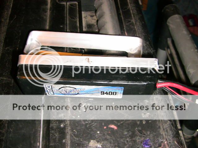

I made my own lipo trays.
YETI XXL HYBRID - Page 2 003_zpsfjsf6rrzYETI XXL HYBRID - Page 2 004_zps3cc89bwv

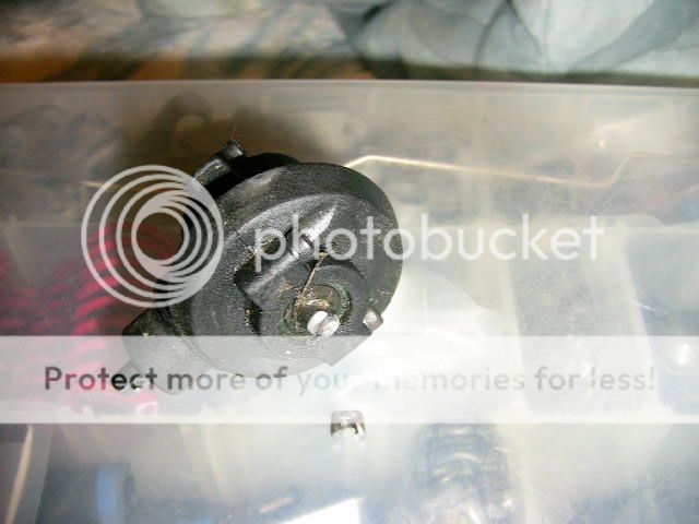

I also broke a Spool in less than 5 min. today on my first run!

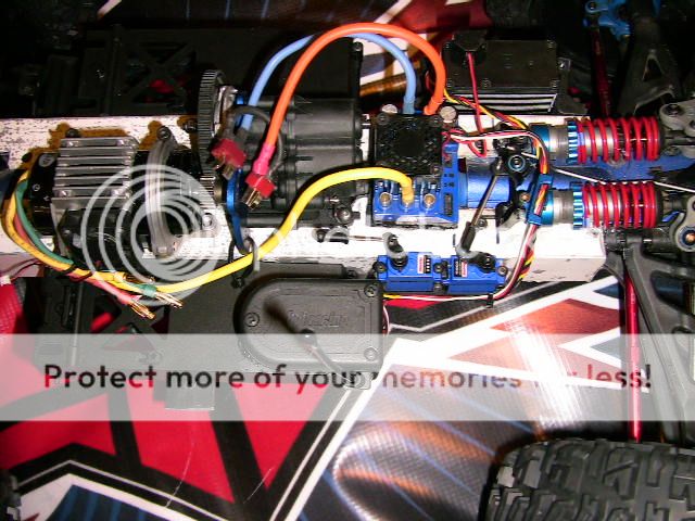

Making sure the 1/5 HS-5755MG servo gets enough power, I added a 15 amp BEC.

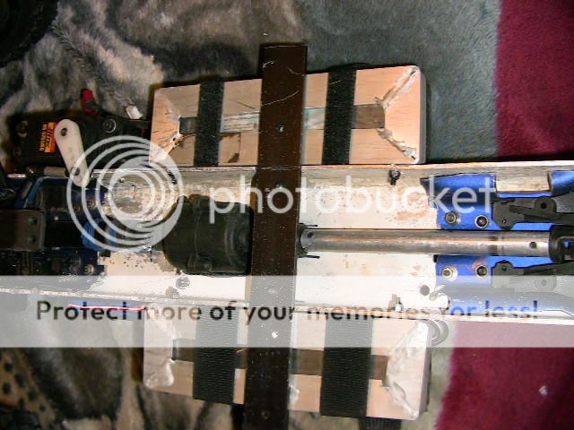

I got the front and rear Traxxas Summit Bulk Heads in today. This will cover the front because for the moment the rear has a spool and it is using the Revo bulk head.
The fist thing was to bolt it to the frame so that I can mark where the shifting lever goes through the frame. I used a file to notch the piece needed to get it fitted.
YETI XXL HYBRID - Page 2 3b63ed27-30d2-4beb-82a2-8c84ac735c24_zpsxhhwfvh2YETI XXL HYBRID - Page 2 F70edaa4-21e4-4160-8bbf-009c6d99b509_zpskbnuujj7
I added to the photo what needs to be done to keep the frame and Bulkhead as one in a build like this. I added longer bolts of course to get the nuts to fit.  with the parts in place it becomes a very stiff front end, Much more so than the stock chassis of both the Traxxas Revo/Summit or the Axial Yeti. Some day soon I hope to make a chassis out of carbon fiber. It will be the last part of the build.

Post by twissted Wed 18 Mar 2015 - 8:14
These 2 pictures show what a difference 1/2 thick foam vs full foam on the rocks. I installed the RC4WD Desert Reaper fronts for this. They are softer than the Proline Trenchers that I had on before. These are also narrower! I think they are more scale looking also.

Post by twissted Thu 19 Mar 2015 - 4:56
I'm having a little fun while waiting for parts.
I installed a Hi-Lift Jack and a larger more scale hood. this time I cut the hood opening so that the motor looks more scale. It is large so, it will get hit alot in roll overs. I built it with a brake-a-way system so that I can make fast easy repairs.
YETI XXL HYBRID - Page 2 YETI%20XXL%20scale%20002_zpsiiigbq4pYETI XXL HYBRID - Page 2 YETI%20XXL%20scale%20006_zpslnxzysevYETI XXL HYBRID - Page 2 YETI%20XXL%20scale%20004_zpscc4ybvkt

I bought 2 mini servos to shift the front end and the trans. I got them from ebay. 1 works and the other doesn't. It's to late to send it back, so I will order another one from him and when it comes in I will send the 2nd bad one back. Its to bad I found out after waiting for ever on the diff cup to come in! I got it all parts in and now I have to wait on parts that don't work. Same thing with the Hitec 5755 servo I bought it used and it is a pile of junk.
In the pictures below is a white container from OFNA that has Diff-Loc in it. you get 1/2 a container (not much) $12.00 I used it in this diff.
