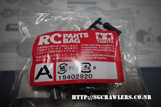

Starting the build..... Bag A

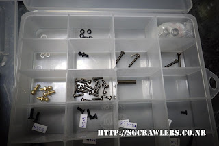

As usual, i'll try to sort out the hardware prior to starting the build... but this kit looks really simple.... so didn't really sort out all the stuffs....

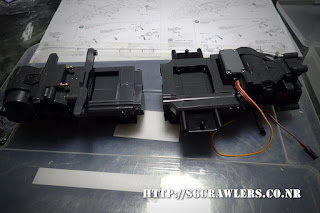

The rear gearbox done....

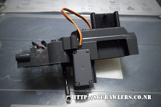

Using one of the spare Hobbyking waterproof servos for this car...
tamiya - Boolean21's Tamiya MF01X Suzuki Jimny P7075142

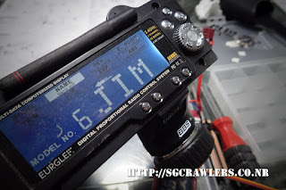

Setting up another model in my usual GT3B radio...
tamiya - Boolean21's Tamiya MF01X Suzuki Jimny P7075143
the linkages for the servo...
tamiya - Boolean21's Tamiya MF01X Suzuki Jimny P7075144
mounted onto the servo

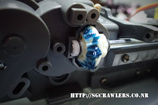

marine greased the gears.....

the chassis is formed up by 3 sections, the rear gearbox, middle section and the front gearbox...

Marine greased the gears...

Way too much grease on the gears btw Smile.

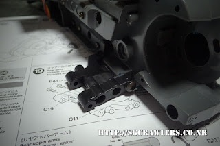

continued with Bag C....
simple and straight forward....
tamiya - Boolean21's Tamiya MF01X Suzuki Jimny P7155187 tamiya - Boolean21's Tamiya MF01X Suzuki Jimny P7155188 tamiya - Boolean21's Tamiya MF01X Suzuki Jimny P7155189 tamiya - Boolean21's Tamiya MF01X Suzuki Jimny P7155190

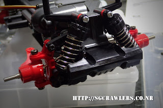

and the rear dampers...
tamiya - Boolean21's Tamiya MF01X Suzuki Jimny P7155191 tamiya - Boolean21's Tamiya MF01X Suzuki Jimny P7155193 tamiya - Boolean21's Tamiya MF01X Suzuki Jimny P7155194 tamiya - Boolean21's Tamiya MF01X Suzuki Jimny P7155196
done up the rear axles....

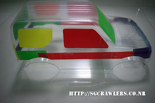

washed and masked the body...
tamiya - Boolean21's Tamiya MF01X Suzuki Jimny P7235234 tamiya - Boolean21's Tamiya MF01X Suzuki Jimny P7235235 tamiya - Boolean21's Tamiya MF01X Suzuki Jimny P7235236
it's gonna be a two toned Jimny... so masked off the upper part first....
and sprayed the first color.... Bright Silver...
tamiya - Boolean21's Tamiya MF01X Suzuki Jimny P7235237 tamiya - Boolean21's Tamiya MF01X Suzuki Jimny P7235238 tamiya - Boolean21's Tamiya MF01X Suzuki Jimny P7235239 tamiya - Boolean21's Tamiya MF01X Suzuki Jimny P7235240 tamiya - Boolean21's Tamiya MF01X Suzuki Jimny P7235241
removed the masks and ready for the second color...
tamiya - Boolean21's Tamiya MF01X Suzuki Jimny P7235242 tamiya - Boolean21's Tamiya MF01X Suzuki Jimny P7235243
Metallic Red!
tamiya - Boolean21's Tamiya MF01X Suzuki Jimny P7235244 tamiya - Boolean21's Tamiya MF01X Suzuki Jimny P7235245 tamiya - Boolean21's Tamiya MF01X Suzuki Jimny P7235246
backed with a coat of white before tearing off the window masks...
cos this time... i tried to use lesser paint... i used to coat the lexan bodies with lots of layers of paint to make them opaque.... first time using only 2 coats for both the silver and red paint....
tamiya - Boolean21's Tamiya MF01X Suzuki Jimny P7235247 tamiya - Boolean21's Tamiya MF01X Suzuki Jimny P7235248 tamiya - Boolean21's Tamiya MF01X Suzuki Jimny P7235249

tamiya - Boolean21's Tamiya MF01X Suzuki Jimny P7245252 tamiya - Boolean21's Tamiya MF01X Suzuki Jimny P7245253
can see that some of the red got into the silver.... i should have backed the silver with a layer of white first before spraying the red....

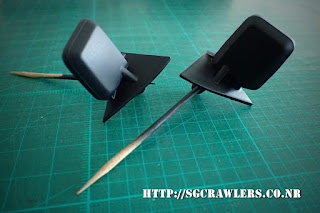

sprayed TS Black for the side mirrors and added a coat of matte clear...

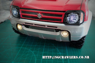

added lights to the little SUV as well....
tamiya - Boolean21's Tamiya MF01X Suzuki Jimny P7245257
