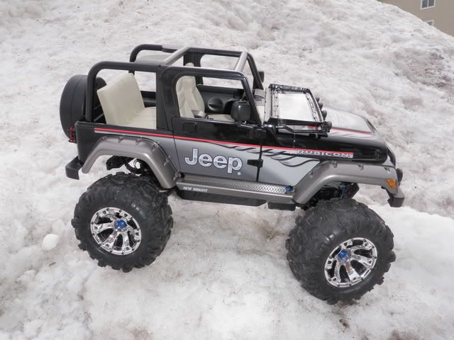

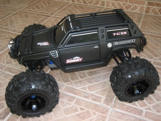

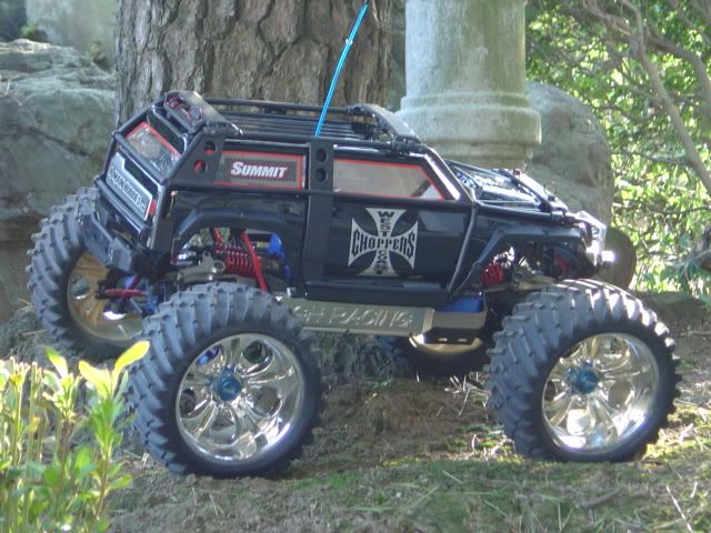

Re: Traxxas Summit
Here are some of the nice shell for summit (DIY)
ket2175- Crawler
- Posts : 1719
Re: Traxxas Summit
Ket the jeep shell is nice. You should try convert it.
Re: Traxxas Summit
RTECH wrote:Ket the jeep shell is nice. You should try convert it.
But no know where to buy leh. Must search here and there liao. Think SLOW will like it too.
ket2175- Crawler
