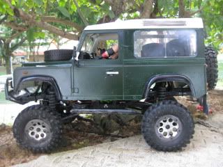

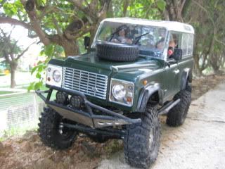

Post by Wrigleys Mon 2 Jan 2012 - 18:41
Just some updates. Changed to AX10 shocks for more clearance. (Need to change shock oil for less flex or maybe change spring too.)
Placed the spare proline wheel at the back.
The spare wheel on top of the hood is just an idea. Most likely will remove it as it is an odd one out here.
If you got any ideas, please let me know so I can improve this vehicle.

Post by RTECH Mon 2 Jan 2012 - 20:12
Change to thicker oil as now your CG is higher to prevent the chassis from swing side to side too fast and topple.
Dun change the springs 1st, test with thicker oil and see. Harder springs will loose traction .

Post by Wrigleys Mon 2 Jan 2012 - 21:31
Ya i feel it sits too high.. Ok will experiment with the setups.. cheers

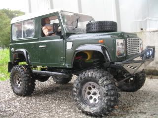

Haha just to update with some pictures. Very Happy
wrigleys' SCX10 Landy Land Rover D90 build IMG_7946
Btw, I changed to stock scx10 shocks to lower the body.. yet to take pics.. Neutral
