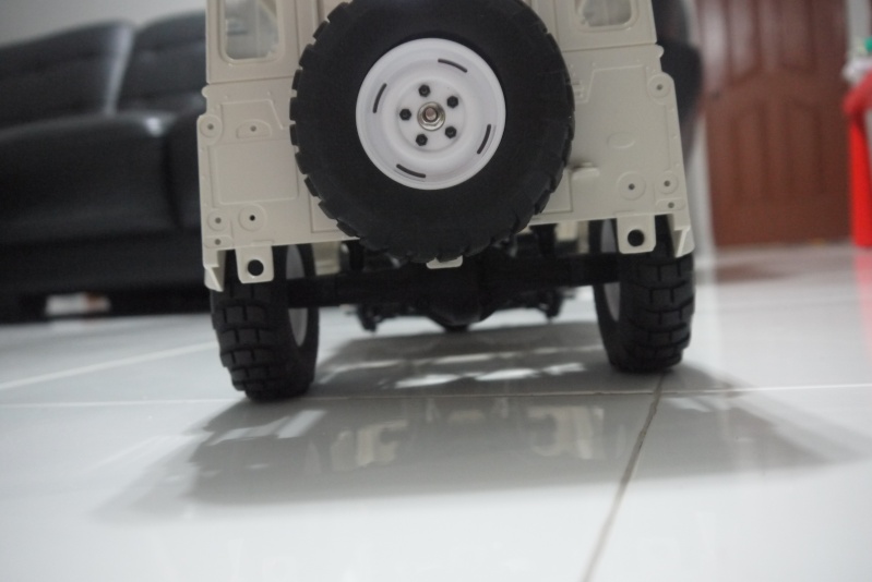

The D90 body has arrived
[img][/img]
The mud plugger fitted just nice within the body.
Some QC that need to be rectified. The other one is OK. I will use this to Mod to the D110. Hope that some heat will correct the flaw.
