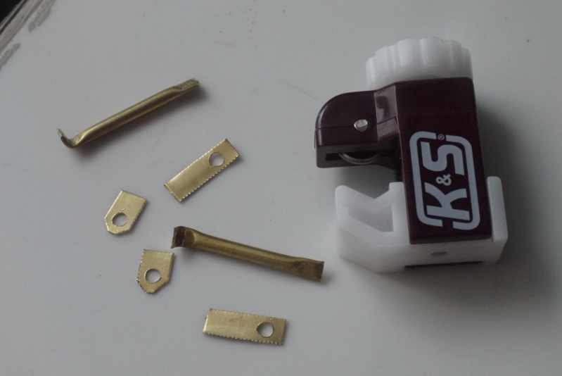

A little update on the DIY Roof rack and front Roll cage. Only the centre is a full solid rod. The whole roof rack and front roll cage is "hollow" brass rod. As most of us having the landy knows that the top is heavy, so I opt for hollow brass rod. Not easy to cut to size. As mention earlier I would prefer 2mm brass rod but since I cant get hold of it yet, I just work with what I have. The roof rack material cost abt $30. Have yet to complete the roof rack and painting will follow soon...
Bought myself a Tube Cutter
[img]BabyBoy's Land Rover D110 on Axial SCX10 - Page 4 P1060610[/img]

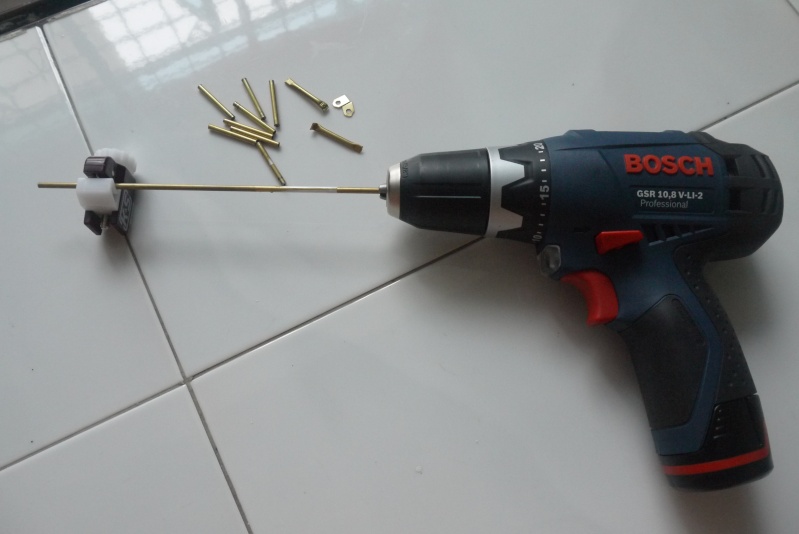

You can use hand to turn the tube. Done it and takes hell lot of time and muscle so I innovate and use this. Makes work faster!

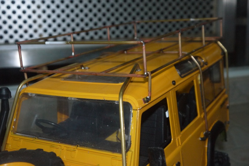

My soldering process all use LOS (line of sight) to get 90 degree so not very acurate but acceptable lah
[/img][img]BabyBoy's Land Rover D110 on Axial SCX10 - Page 4 P1060612[/img]
