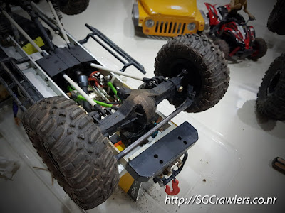

Survived all these years until recently, the front axle seems to be stuck....
So, time to open up and take a look....
Look at the wear on the axle case... Razz
One of my favourite and most used trucks... I'm sure you can see based on the axle case...

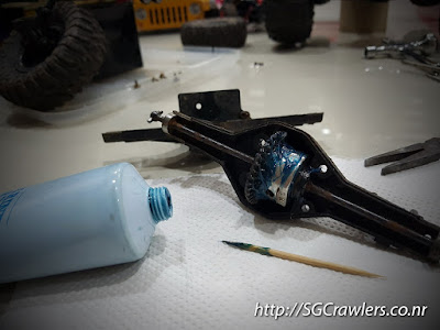

The internals..... rust and mud... mixed with grease from the day it was built....
Seems like the ball bearings gave way... and the little metal balls in the ball bearings came off and got stuck on the gears... hence causing issues on the axle....
build - Boolean21's AEV Jeep Brute 1/10 scratch build - Page 4 20161009_204742
Gave it a good scrub to remove most of the mud and most importantly, the little metal balls...
build - Boolean21's AEV Jeep Brute 1/10 scratch build - Page 4 20161009_211832
Coated the gears with Marine Grease... this is the same tube that I bought when I started this hobby.... It lasts for years! Very Happy
