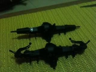

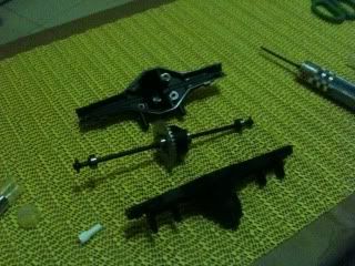

Followed the manual step by step. Axles started first.
Completed the axles.

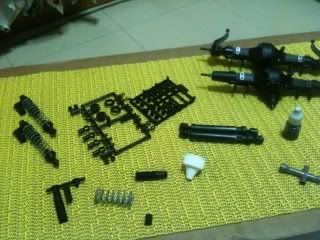

Next are the shocks. This time the rubber seals are holding the silicone oil in. Laughing

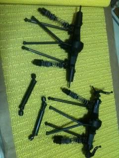

Completed the axles, upper and lower links as well as the drive shafts.

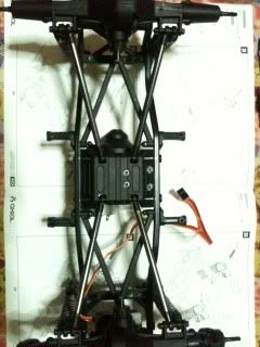

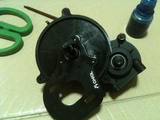

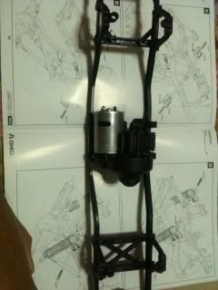

So today all the time I had is building the tranny.
Finally I know how a slipper clutch works.. All because I tried building a kit..

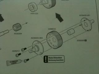

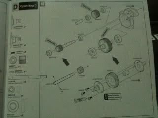

Got confused here on pg 19 step 18. After looking on the internet, Part AX800009 (5) does not fit and I had to skip that part. Other build forums confirmed to skip this part.
Mounted the motor and the tranny onto the skid plate. No pics for now as I have kept them in storage.. Till then... cyclops

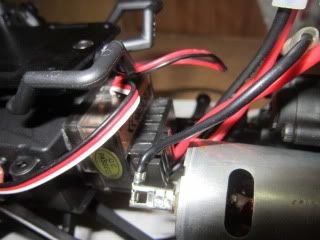

First up, it is to wire up the electronics. Again I use cheap china esc, servo, silver can and HK GT-2 rx. All for less than $50.

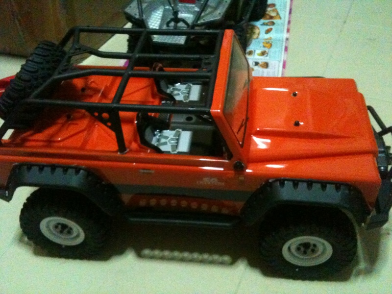

I decided to use my Honcho cover on this shorter wheelbase Dingo SCX10. It turned out pretty nice.

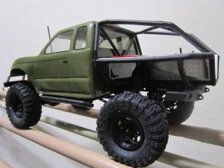

Finally the rig is complete. Very Happy
Dingo on 1.55 Mud Trashers. Too small..

Two things to watch out: on top of the axles are holes for the 4-link suspension that is not used on the Dingo. Close them or otherwise dirt/mud/water goes into the axle. Just some spare 3mm screws will do.
Also ensure that the drive shaft pins are aligned when you mount them. Step 10 on page 15 of the manual has a warning about that on the bottom of the page, but it is a bit difficult to understand. If you don't align the shaft halfs properly your Dingo will "bounce" when driving at certain speeds.
