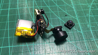

Opened up the mini cam
Removed the IR LED ring
Cut off the stock lens using a pen knife
Test fit the wide angle lens onto the camera sensor.
Fits nicely!
Clamped the lens onto the sensor and applied CA glue.
Testing the camera before fixing back into the housing
Modded the stock bracket with a bigger hole to fit in the wide angle lens
done! still fit back into the stock housing with some mods
Ready to fly again with the wide angle lens!
