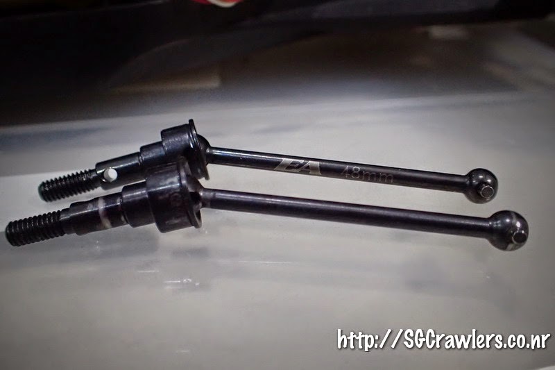

and ordered a pair of new CVDs from Eagle Racing... recommended by our resident Drift King - Rtech...
got a few lengths.... was recommend to get the 48mm length
replaced the broken part.....
and swapped out the ok one as well.... just in case....
now the OTA-R31 is ready for the next night drift meet again!

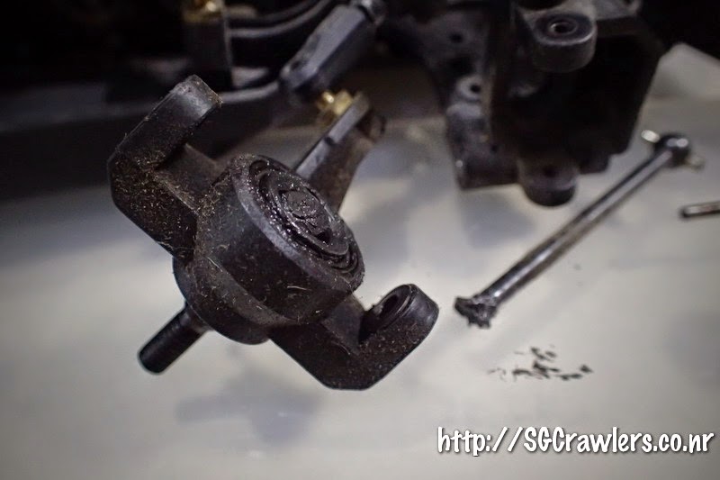

Noticed that the front left wheel didn't turn smoothly....
So, opened up the left hub....
Realised that the universal joint broke... which caused the steering arms to get in the way of the spur gear and in turn... worn out the spur gear... :'(

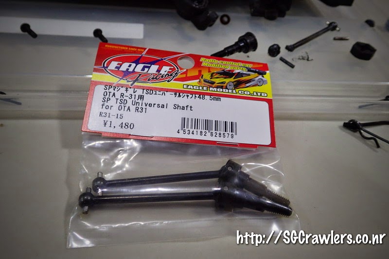

This is the previous set of 48.5mm from Eagle Racing as well...
