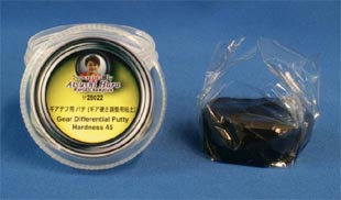

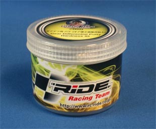

something to share with you guys.. this is a differential putty, it helps to give a limited slip diff effect, and it works very well for me so far.. if someone wants to trail/crawl and run for all terrain, this will help alot as there's no need to use a diff locker, just use this putty.. they have different hardness, and quite cheap.. 10+ a small tub, can use for at least 4-5 cars/trucks. i put this in a friend's exo terra, instantly made a huge difference.. of course with sealed diffs, silicone oil is usually used to control the differential slip.. but this is a good option for those cars without sealed diffs, like Tamiya's TT-01, DF-03RA, i DIY-ed my own LSD for my TT-01, but this makes life much much easier.. u guys should try it out! available at tai sing!
