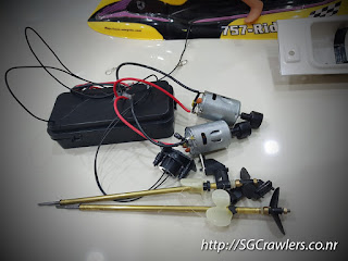

This is a photo of the NQD Jet ski before the mod...
build - [Build Thread] Boolean21's NQD RC Jet Ski conversion from dual motor to jet drive 20160926_192120
The stock battery compartment
build - [Build Thread] Boolean21's NQD RC Jet Ski conversion from dual motor to jet drive 20160926_192136
The stock counter-rotating props
build - [Build Thread] Boolean21's NQD RC Jet Ski conversion from dual motor to jet drive 20160926_192530
Cutting up the battery compartment........
build - [Build Thread] Boolean21's NQD RC Jet Ski conversion from dual motor to jet drive 20160926_192924 build - [Build Thread] Boolean21's NQD RC Jet Ski conversion from dual motor to jet drive 20160926_192929 build - [Build Thread] Boolean21's NQD RC Jet Ski conversion from dual motor to jet drive 20160926_192938
Tore out all the drive shafts,props, and all!
