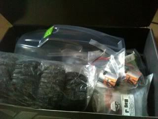

Delivered in a week from Tower..

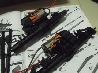

I had this from my AX10 so gonna use it in the mean time. Proline Hammer 2.2
Wrigleys XR10 Build IMG_3510
Wrigleys XR10 Build IMG_3511

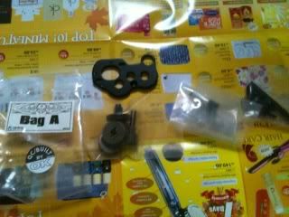

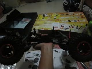

The build starts..
Wrigleys XR10 Build IMG_3512

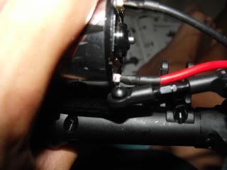

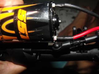

Had trouble along the way.. As you can see from the pictures, the button head was hitting the motor and restricting the steering movement. Quick SOS to Boolean. After filing and trimming the ball end to make it shorter, the button head finally had enough clearance to slide beneath the motor. Thanks Boo!

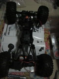

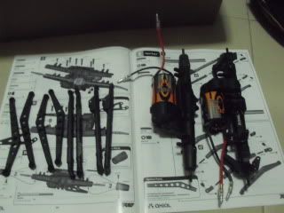

All in all, managed these in 5 hours. My first kit and very noob at this.. The pictures self are explanatory guys..

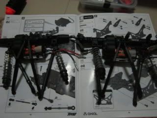

And so the build continued. Poured another litre of midnight oil to complete this roller.

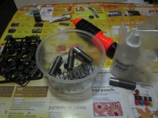

Started off with building the shocks. Quite straightforward for a newbie like me and got it done. Take note not to pour too much shock oil as the kiasu me who poured a little too much made the oil leak..
Wrigleys XR10 Build IMG_9008
Wrigleys XR10 Build IMG_9009

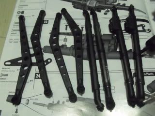

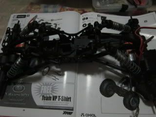

Fixed it to the front and rear axle together with the lower and upper links.
Wrigleys XR10 Build IMG_9010
Wrigleys XR10 Build IMG_9011

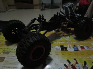

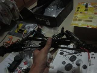

Soon the xr10 took shape.. Laughing
Wrigleys XR10 Build IMG_9012

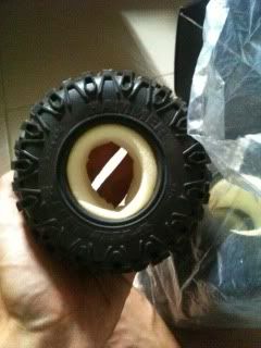

Finally mounted the tires and locked into place.. It came with wheel weights for the front. Nice of Axial to include those.. Pictures not taken though..

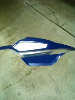

I am still waiting for the esc which has been a month now so I decided to cut and paint the body.
Used these 2 paints from Jethobby. Costed me about $5.50 each.
Wrigleys XR10 Build IMG_2052
Wrigleys XR10 Build IMG_2043
Sticked the window panels with the provided tape and also ran a tamiya tape across the lower part of the body.

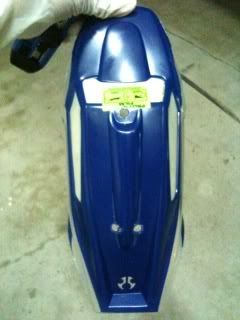

I probably applied 5-6 layers of blue (as what I'm told, darker colour first)
Removed the painting tape for orange paint to be applied.
Wrigleys XR10 Build IMG_3763
Wrigleys XR10 Build IMG_3765

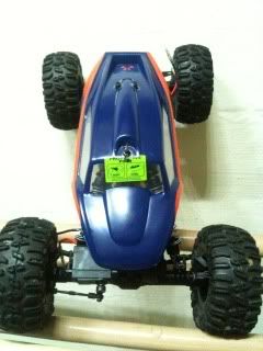

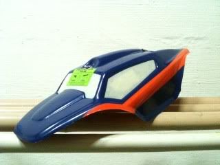

Applied 3-4 layers of orange for the final touch. The painting was quite a rush job and if you look closely, it is far from perfect. pale

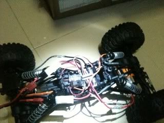

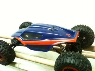

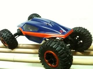

Rig Completed. Using 2 320A China ESC (forward, reverse and brake) and a 4PL to control the 2 esc.
Wrigleys XR10 Build IMG_3978_zpsc3f9a4b1
Wires are in a mess but I will get it sorted soon. Laughing

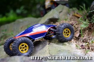

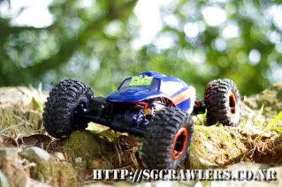

Pics taken during the last crawling session on 23 September thanks to Boolean. So far so good. Razz
Wrigleys XR10 Build Imgp8211
Wrigleys XR10 Build Imgp8227

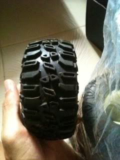

Stuffs that need to be upgraded eg. better tires (HB rovers like the 2nd pic loaned from coldman, metal servo horn and shocks. Stock shocks leaked but still usable.)
